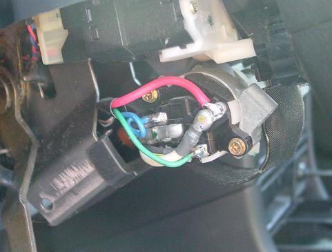

alright i have all the wires ran but need advice/tips or whatever for the wiring into the ignition i found on one website to solder the wires inplace, another said to find were the wires met at and tap into them there, anyone who has had some experience with this please help me out

tap onto the wire from ig to fuse box

so find out were the wires run to before they hit the fuse box and 3 way splice them pretty much?

for what car?

96 integra, trying to get all my wireing done so i wont have to do anymore wireing once i go to boost the car in about 6 months hopefully.

almost directly below the steering column, you will find a big gauged connector with a black yellow, white, and red (I think). You cant miss it. Those wires leads directly to the ignition. I tapped mine into those.... if not, follow the attached pic.

k i followed the picture for now but yeah when i go to turn the car off and see if the timer works the car just shuts off, i havenot yet installed the ebrake safety thing any ideas?

the e-brake and speedo function is not really needed. Mine is not hooked up.... switch the blue wire and the green wire... see what happens....
