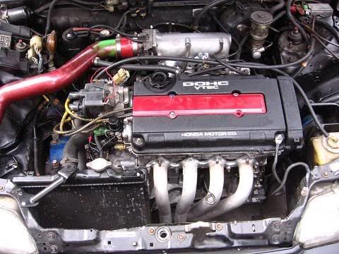

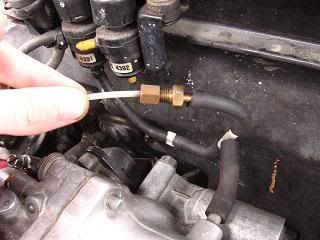

Originally Posted by Smokeless EF
I am shooting two codes on my ECU though.
3?
and 14-IAC (typical damn honda)
Just as i thought....3 is MAP sensor. Your ecu thinks you are running at WOT all the time thus DUMPING in fuel. Make sure your map sensor is wired right and has a much lower voltage while the engine is running vs. just the key being on. Also make sure you have a vacuum source running too it and the vacuum isn't plugged up by something. I swear everytime i see a car drinking fuel like this its almost guaranteed its a map sensor issue.
Damn, Thank you man. I'm going to go check into that right now, thanks.

Default Re: Bad GAS mileage? Like...bad...
Uploading pics of map sensor now..
just get a newer TB that has the map sensor on top and run that and trash all that BS on your firewall

3 and 5 are both map sensor cel's,plus the top plug on the map is for emissions
I forgot all about that. I'll see what I can do.
