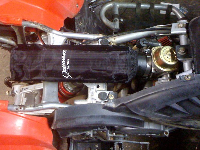

What I have is a 04 Polaris predator. What I have done is added 2 extra holes to the slide and cut 7 coils from its spring and dremeled the intake side of the card a little to get more flow. Here is my intake, I have a pure Polaris (same as what white brothers made) exhaust with the baffle discs removed and the spark arrestor too. I haven’t a clue since I have never jetted before and only did the jets and setup as the dynojet kit suggested with an aftermarket intake and aftermarket exhaust with a high flow baffle, since mine don’t have a baffle/spark arrestor I figured it couldn’t get any higher flow . I am running a 175 main jet, needle on the 2nd notch and mixture screw out 3 turns. I am getting a little forward fire or what sounds like it could just be misfire. Plus when lightly on the throttle putting around it seems to misfire and even die. This is just when I lightly press the throttle while in neutral or in gear. What would be a way to solve that? Different jet, mixture screws adjustment or different notch on the needle? Am I running rich? Plus there is a slight lag when mashing the throttle down. But through the rest of the throttle range it seems to be fine and pulls hard. Figured since there isn’t an ATV section this seems to be the best place. I was going to go to Slades to try and tune it but don't have the time now gotta get ready for my trip back home but would like to make the nessecary adjustments when I get there to get it tuned right. TIA.
