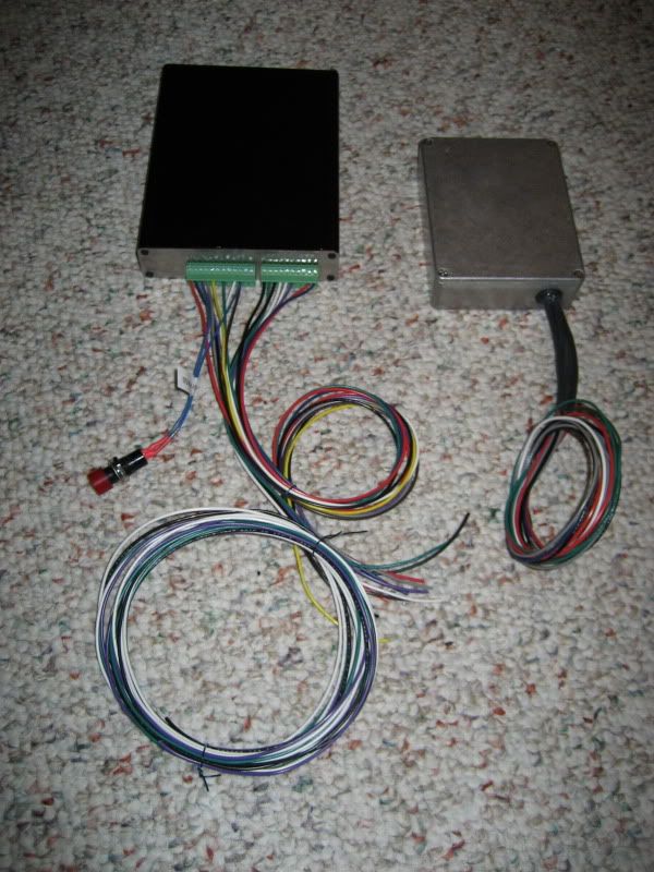

Originally Posted by TYPE JDM
This is the module/Piggy back im running with the ecu.
http://img.photobucket.com/albums/v2...jdm/Module.jpg
[http://img.photobucket.com/albums/v2...dm/Module2.jpg
Custom made By RichieV6 from Chicago.
pm me about the air/fuel issue.
