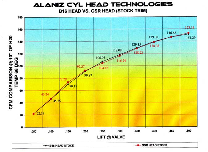

Reliability depends on many factors. Who knows what your driving habits are and what kind of set-up you have. Not to mention tuning. Simply saying, Dart block, GSR head, xx psi doesnt help anybody. I'm sure you already have a turbo size and fuel management in mind. I guess what you really want to know is what pistons/rods combo people would recommend. If that's the case, then do whatever everybody else is doing... CP 9.1:1 pistons and whatever after rods.....
GSR head and B16 head doesnt have that much of a difference on stock form. I will post the flow sheet later.

flow chart

Cool. Thanks for the flow chart. Now, I guess the point of all this would be to ask if anyone here knows of anybody who has had there build last awhile. What they did and so on. Trying to get info on this subject as much as I can. I am just trying to learn.
