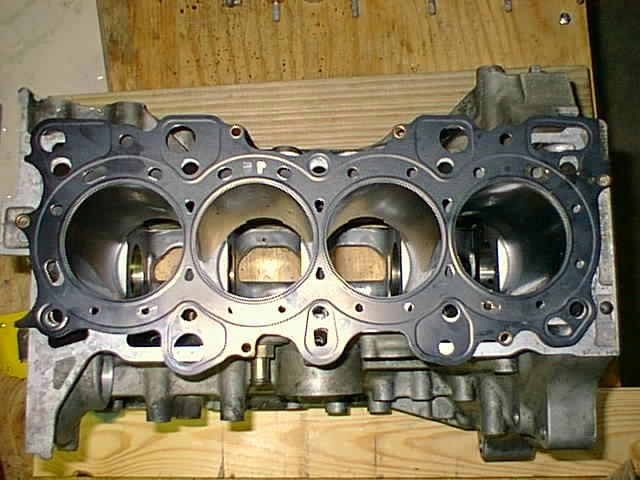

Edit: Here is a pic of how different the b16 head and the b20a block are. I can't seem to find anything specfic about the b18b head but I think the bolts are about the same as the b16. Someone correct me if I'm wrong.

Here it is.

yea, the b16 head and b18b head have the same pattern, but i didnt think the prelude head would, plus, im sure if it could be done we would have already heard about it........
