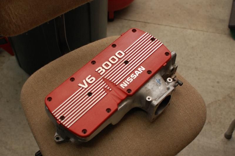

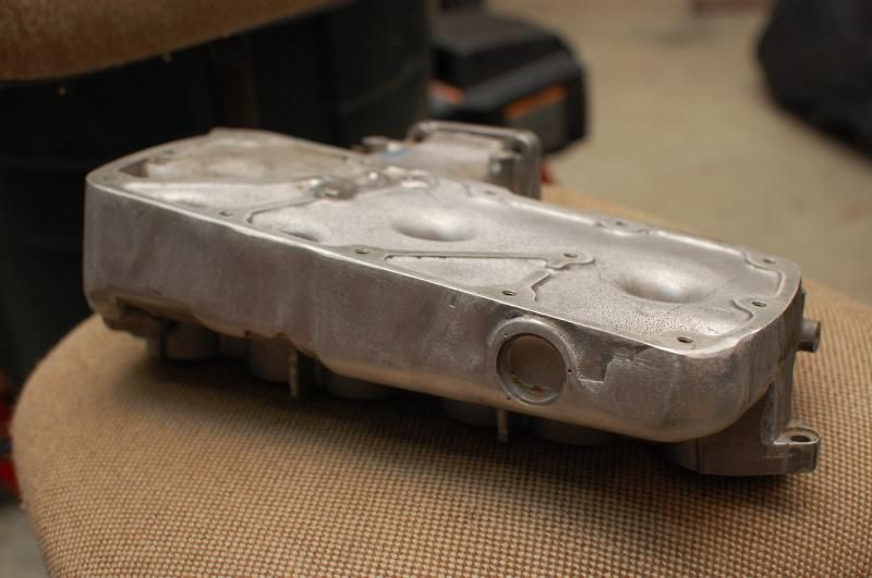

Snapped a few pics of the new intake now that it's back from being modified. Planning to try to get it powdercoated and installed this weekend. From an 200SX SE V6 (S12).
And a quick one with the top plate on it. This has already been powder coated.

Are the runners bigger or whats the reasoning behind using this part?
Old Jan 23, 2015 | 05:29 AM
  #57
jaqattack02's Avatar
Joined: Jun 2008
Posts: 1,160
From: Aylett
jaqattack02 jaqattack02 jaqattack02 jaqattack02 jaqattack02 jaqattack02 jaqattack02 jaqattack02 jaqattack02 jaqattack02 jaqattack02
Default Re: Z31 300ZX Project
No, same size runners. The main reason I'm using it is for space.I currently have issues with the stock plenum being in the way of my FPR (pretty much can't access it without removing the plenum). This should also let me shorten my piping from the intercooler just a little. I'm also theorizing that it may reduce turbo lag just slightly because this has a smaller volume, so it will take less air to bring it up to pressure. But I'm not an expert, that's more of a guess.
It's also a fairly rare part, they didn't make many S12s with this engine. So it's something to help stand out when I take it to car shows.
Also, for comparison, here is how it looked before it got modified and cleaned up.

I forgot to mention it's also more free flowing. The inside is open besides the vertical "columns" where the mounting bolts go through. The old one has a bunch of curvy passages and stuff to route air evenly by bank and cylinder. It works pretty well on non-turbo cars but gets in the way for boost.

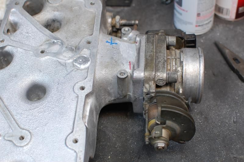

While we had the throttlebody off Kevin decided he wanted to clean up the unused fittings on it.
Before
After
Here it is mounted for mocking up all of the vacuum lines and throttle cable before we started powdercoating it.

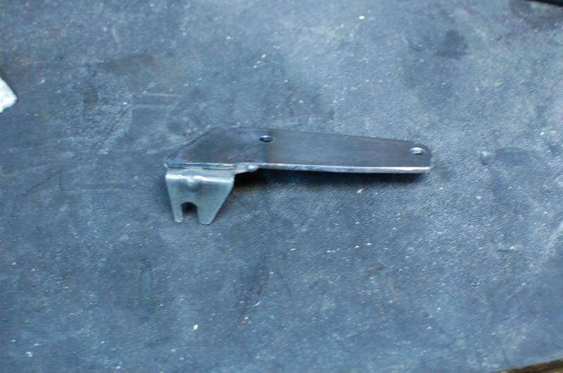

This is where we discovered the extra work we made for ourselves. Apparently we got over enthusiastic with the marker when we were marking what we wanted our fabricator to remove/fill. One of the things we had him remove ended up being the mounting bosses for the bracket for the throttle cable. So we ended up having to make our own. We used a piece of scrap steel and one of the brackets off of a Z31 plenum.
The smooth area just behind the throttle cable hook up should have had some mounting points.
Here is what we came up with, prior to powdercoat.

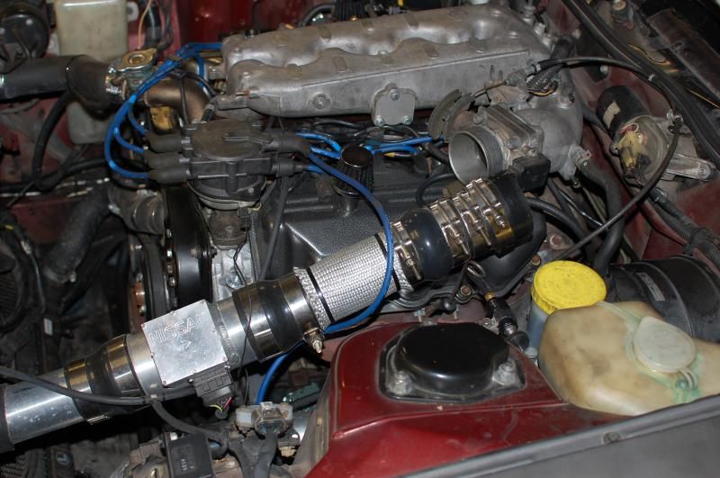

Here is the final product with the piping hooked up.
