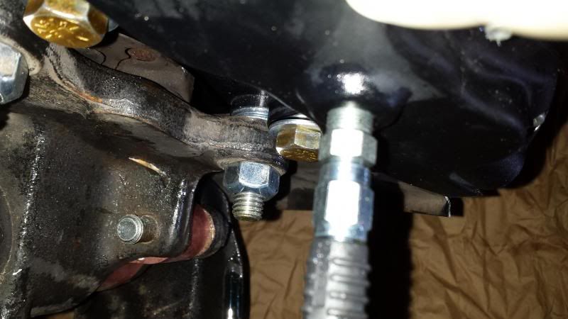

UPS man dropped off a stack of goodies last night. Wilwood Forged Superlite 4 piston calipers with the accompanying brake lines and pads. Running them with a set of adapter brackets and 350Z track rotors.
Rotor test fitting.
Everything installed.
Still need to bleed them. I'll get more pictures once it's on the ground.
Also working on building a set of OWO heads for the car. Got them all assembled, just need to find time to install.
Since you guys are likely unfamiliar, OWO heads came off of later model vehicles with the 3.3L version of my engine. They are an updated casting with better flowing ports and larger exhaust studs (less likely to break off). Mine are getting adjustable cam gears, Isky 272 cams, and 110lb Schneider valve springs.
