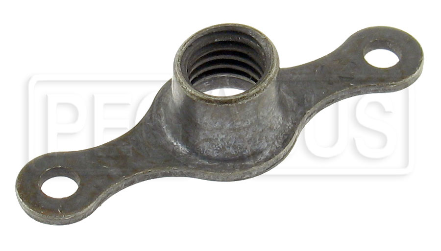

Another solution is to get one of the stamped steel locking plates that are designed for this, they are a teardrop (one small mounting hole) or football (two small mounting holes) shape usually, with a hex cutout for the bolt head. All you have to do is slide it over the bolt head and drill and tap the small hole(s), and you have a locked bolt.
This is the best I could find in 5 minutes, it's similar to what I'm talking except that it's threaded instead of having a hex recess for the bolt head. You probably get my drift though..

^ Link to this device you speak of? I'm really only trying to tack the bolt head in place... no major welding, just a tiny little tack. However the thing your talking about souds exactly like what I want.
