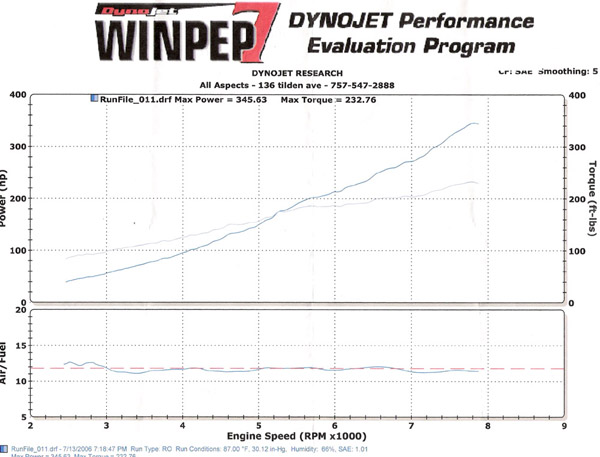

Attached is a dyno chart of my boys turbo B16 that Ross tuned. It was just a QUICK tune. My friend didn't pay him but an hour. Another hour and things could have been damn near perfect. He did it in like 4 or 5 pulls. Different cams were going in the week after so he just did a quick tune and got the AFR's and VTEC smoothing pretty decent for the little time it took him. I guess it would make a difference with NA motors being more affected by small timing or fuel changes.
apples and oranges....
I went throught the all motor dyno thread and 9 out of 10 of the afr charts had the same spike....
And god knows that if I "just took my car to ross" I would have made 250...
