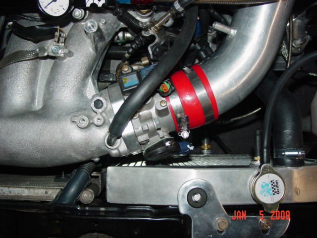

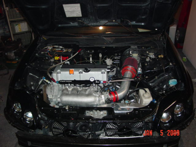

Yes I am well aware the the Z3 motor came with the RBC intake and I have already put the RSX TB on the car via Karcepts adapter and I am using the wiring harness off an 03 manual Type S. I have it all installed in the car already, hence the idle issue. There is no way to use the factory ECU and try to run the DBW system in the older cars unless you rewire and customize everything. I have seen the dual piggyback ECU setup and am not too impressed.

Just a couple pics of the car, I have a ton more on myspace.com/staleydj

You didn't answer my other question.
Are you still running the maf sensor?
well looking at your pics no. lol.
Have you checked the map sensor also?
I kinda want to see this swap lol. got me intrigued.
I just looked at my sensors try switching them.
