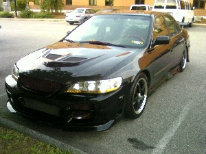

Hey I got a turbo automatic accord 98 4cyl sedan and I can't find an EMS for a auto accord.... the problems im havin is the AF won't even get anywhere close to rich and the psi that won't stop spoolin until i let go of the gas to make the rpm's go down....i need tuning bad plzzzz help...

I don't think he means what you think he means...by "psi wont stop spoolin until I let go of the gas" do you mean that the boost is constantly building until you let off? If that's the case, then you're obviously not actuating the wastegate...are you external or internal WG?
Also, if you are running that lean, then you probably don't have something hooked up properly.
Typing like a grown-up, please give us more specifics on your set-up and what EXACTLY you have done so far (install and troubleshooting).

turbo kit:
t3/t04e turbine/compressor
drag blingbling pipes
intercooler
oil feed
downpipe
blitz dd bov
tial 35mm wastegate
vortec fmu (came with kit, never used, so it's new)
airtex inline fuel pump (came with kit, never used, so it's new)
apc air filter (purchased 3 months ago, still looks new)
all silicone couplings, clamps (blue)
some misc hoses, vacuum tees
Thats my kit. Everything was professionaly installed. This is the deal with the psi....I push the Gas and the turbo spools to 10 psi instantly..ok...the longer i hold the gas the more pounds it will push until i let go...the boost will get to about 17/18 until it starts to spudder...and the deal with the vafc reading lean..we tried to put a adjustable fuel reg. on it today and that didn't do shit...all it did is make it a little better...its reads about 3 or 4 red bars instead of just 1 before the fuel reg.
