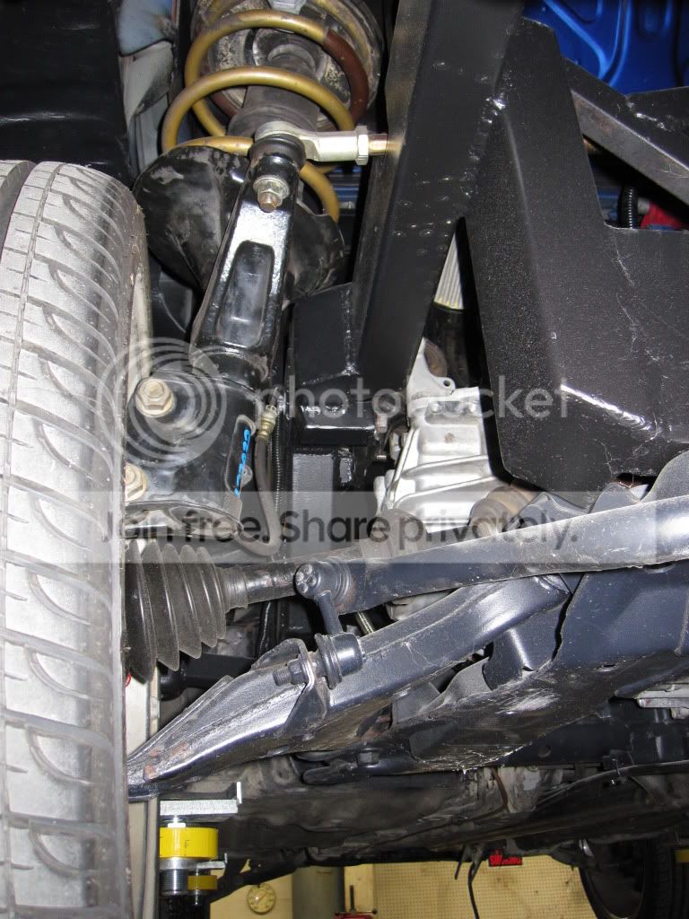

Originally Posted by Broke Neck
Evidently the motor thats in there is just for mockup
There's a lot more metal back there than I realized, there has to be at least 100lbs of tubing back there, easily. That makes a NASCAR side impact cage look like matchsticks.

I liked the boxyness and overall new frame... Yea, it is heavy, but I bet it'll hook like a bitch...
But then again, this is coming from a guy into minitrucks... I'm used to seeing shit like that... I do know that there is a lot of math in that engine bay shot...
I'm not convinced of the math part. It there was a lot of math involved, that would be a lot more minimalist. I get the feeling there was a lot of guesstimated reinforcement going on.
I wish I hadn't seen those extra pictures. I still like it, but I'm not as impressed after seeing the rest of it.
thats why i wonder why people use del sols to do this. i thought about all that shit they had to add to the del sol to pass crash tests when they first came out.
Well the part that I don't understand is throwing away the entire rear end of the car except for the exterior sheet metal, and then build this huge cage/cradle for the engine and suspension. I'm sure that's kind of an easy way to go about it, but you'd think it would be easier, lighter, and stiffer to add some mounting pads to the unibody and then make a minimal cradle to mount to that. This is the same type of stuff that is done in the front or back of race cars; relocate the engine in the chassis, make a minimal frame that mounts the engine to the unibody, add some minor bracing, and let the OEM chassis do what it was intended for.
The only really important part is to keep the engine from moving around while putting power to the wheels (which is almost trivial) and to locate the suspension, neither of which require a frame that would make industrial machinery blush.
