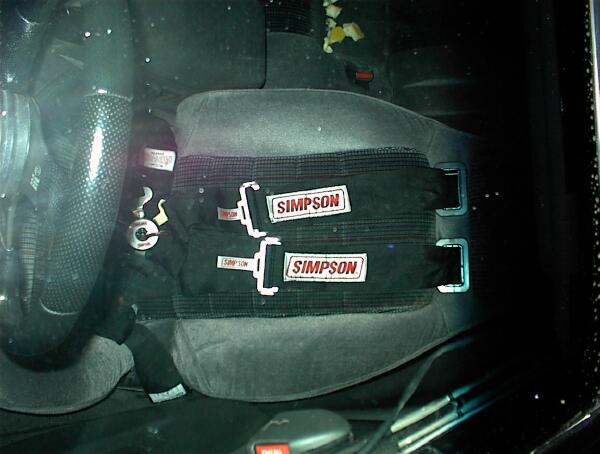

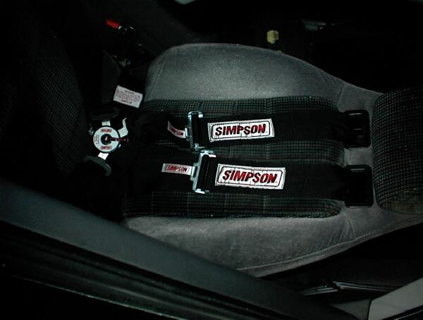

Thought you guys might appreciate my latest mod...
The pics kinda suck though..
The harnesses are Simpson (obviously) 5 point cam locks. I bought some Corbeau belt grommets and cut the seats for them. The two shoulder harnesses are Y'd together. Everything pretty much clips in. All the ring bolts that came with the harnesses threaded into spots in the car. The only hole I had to drill was the one for the shoulder belts.

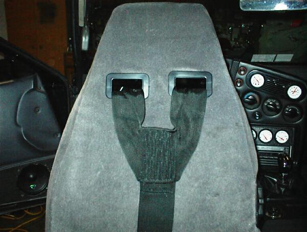

Cutting the seats was not real difficult. I've done a few nationally competitve car stereo cars, so I'm pretty handy with fabric and stuff, but I honestly think it's something that anyone could do.
You basically position where you want the grommet to go and draw a circle on the inside with a Sharpie. Then cut a X in the fabric (I.E don't remove the fabric). Then you do the same with the foam except you actually remove that (you can see peices of foam sitting in the back seat on one of the pics). Behind that (in my case) was metal. Again use the grommet as a guide and trace it out. Then I used a drill to punch a bunch of holes in the metal, then a dremel to "connect the dots" and smooth out the opening so the grommet fits through. Another square of foam is removed. Push the grommet in furthur and cut another X is the back. There's a second grommet that comes in from the back. The hardest part was cutting the metal. and keeping the fabric out of the way. I do need to shorten the grommets just a little though for a cleaner look. The grommets were cheap too, $11 direct from Corbeau.

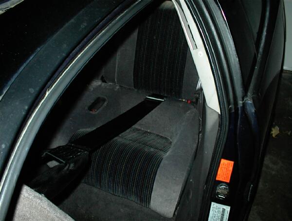

The shoulder straps in the back go right between the seat bottom and the fold down upright. I'll get a picture of that when I actually do that part (I have the hole marked, just haven't drilled it).
As for the anti submarine belt. I have it. I just haven't installed it yet. I'm debating on if I want to cut the bottom of the seat and install a grommet or just wrap is around the front. That's why I haven't done it yet.
Last, but not least. The bolts are threaded into where my stock seat belts bolt in (sorta). I'll take some pictures of them tomorrow. I still have all the OE belts installed and functional.

Here are a few more pics I just took of the mounting and seat back. The grommets in the back are alittle off.. I'm going to try and get them even but I don't think it's that big a deal. you won't be able to tell when the seat is in it's normal position.

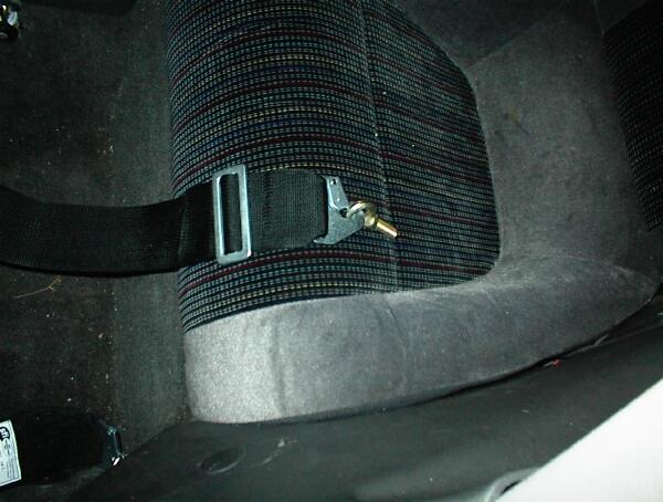

This is the inboard mounting ring. It threaded into a bolt used for some slider that goes through a bracket in the seat that the OE belt latch is attached too

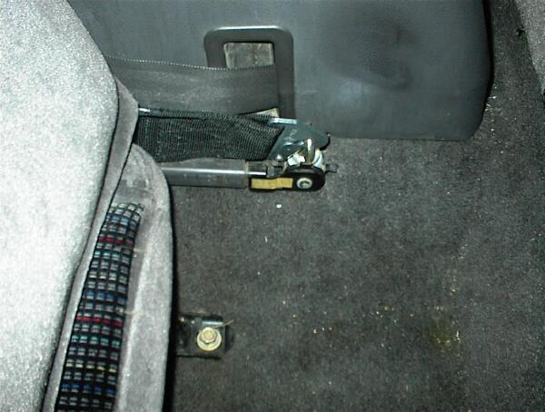

This is the outboard mount. It threads in to a bolt hole that is used to hole the OE belt tentioner in.
Back of the seat...
This is the end of the shoulder harnesses with the Ring bolt and the spring loaded clip end

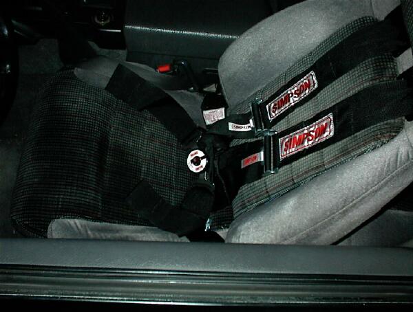

This is the shoulder belt mounted. It's loosened up so that I could move the seat..
